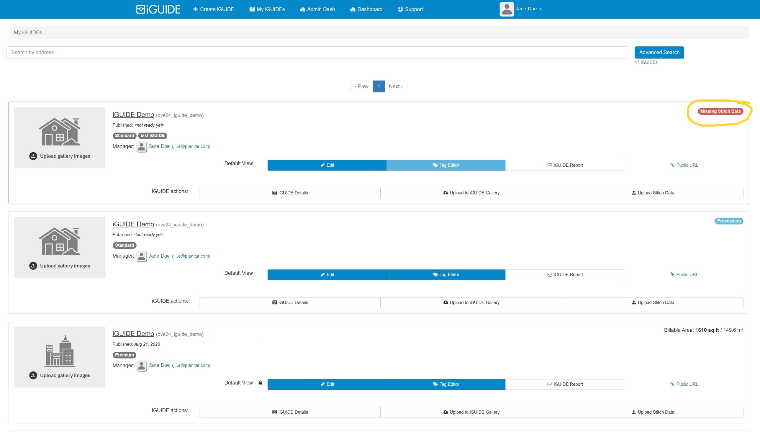

Example: The Missing Stitch Data tag appears in red at the top right of the iGUIDE in your My iGUIDEs list
